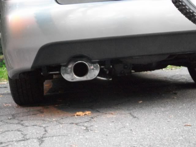

installed!!!!!!!! pics on 1st post

Re: New 3" CBE on the way
Looks great man, congrats!
looks good. you still going to spray it with the VHT?
Post by goob_os101 »
I think I will do the pipes and muffler and leave the tip. It is really shinny! :5-0:
just do the back of the can. the rest will be dingy in no time. :wink:
Very nice!

Looks good. Fitment looks perfect. If it isn't too loud, I would say this is a huge win!
Looks good.
goob_os101 wrote:I think I will do the pipes and muffler and leave the tip. It is really shinny! :5-0:
I concur w/ this decision and feel it necessary in these parts.
