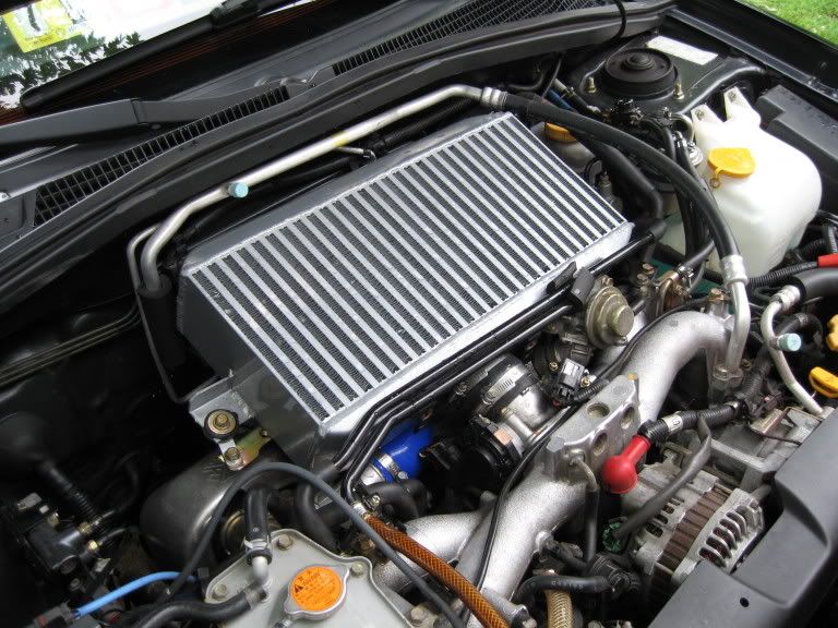

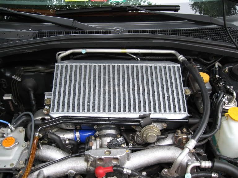

Oh, and since my STi TMIC was out (b/c the pitch stop is right underneath), I decided to throw this in:
(note the temporary breather pipes and custom mounting bracket...you can see in the third pic that I had to remove the splitter...will have to make a custom one now)
Looking good Will! Did you replace the Y hose with a silicon one?
Thank you, sir. It is a cast Y pipe w/ a blue silicon elbow hose that I had to trim to fit the VF39. I will be designing a custom splitter w/ CAD this week to work w/ the new TMIC.sabre wrote:Looking good Will! Did you replace the Y hose with a silicon one?
