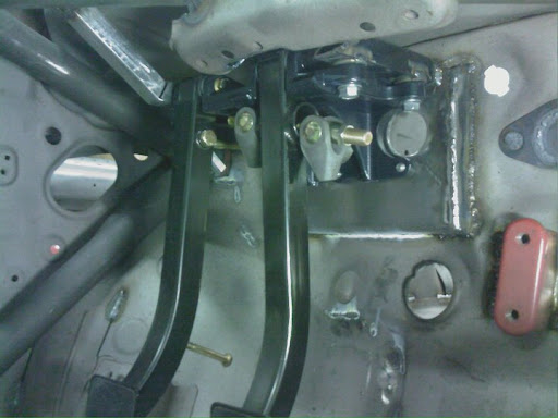

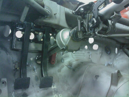

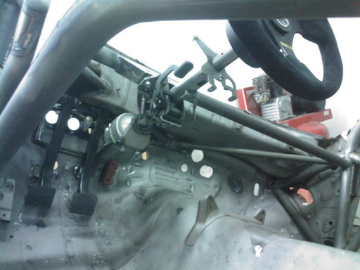

New clutch/brake pedal assembly ordered and on the way!
The factory pedal box was not working the way we were setting the car up so it these Tiltons will be going in,
Re: EJ205 GC Coupe
Pedals now in.

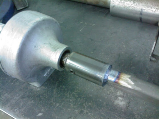

- Weld/install Howe 1.5:1 steering quickener.

Haven't heard of the Howe rack. I do know many of the Subie's I've codriven in rally have the Q-Rack.
http://www.q-rack.com/
Re: EJ205 GC Coupe
It's not a rack. It's a quickener that goes in line with the steering column.
I'm familiar with Q-Rack and it's certainly proven. However I'm avoiding modifying the rack due to the cost and the fact that the rack is much more likely to fail than the column. This has been used very successfully in the past by other people I have known. It basically gears up the column. This also gives me good options based on the fact that it can be flipped to gear down the colum... or it also can be used with different racks to produce different results.
Apart form this the Howe quickener is easily removed, and easily disassembled for maintenance and much much cheaper.

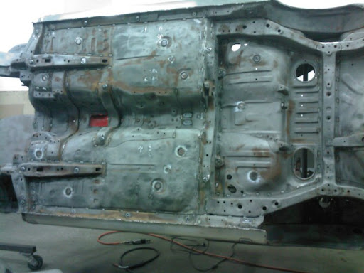

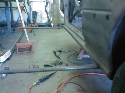

Well the cage is officially done. Gussets are in and everything looks great. Now to finish the rest of that do-do list.
So it looks like we're going with 20 gauge steel rocker panels. The company that Andrew knows if fabbing them up right now. They shold be ready inside a few days and then those go on.

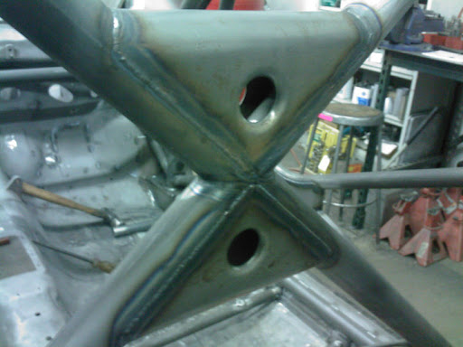

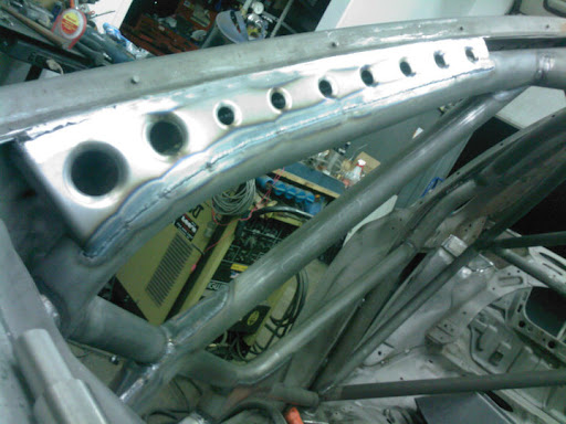

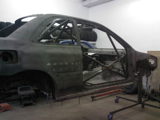

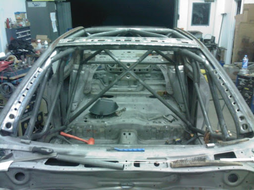

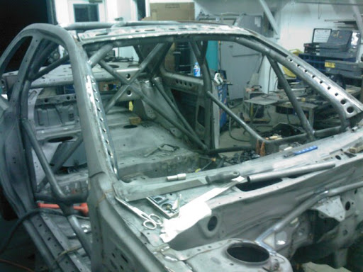

Things are coming to an close at Havspeed. Just a few quick updates:
Steering quickener installed
Gussets and pin stand mounts finished (cage now done)
Steel rocker panels now on
Just a few more seam welds and some weld-nuts and we'll be ready to powdercoat.

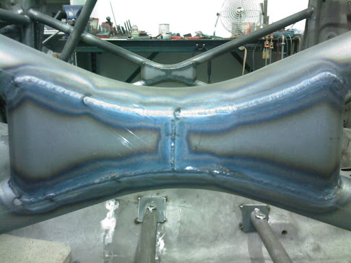

More pics coming soon. All welding is now done and the hydraulic handbrake is mounted (not hooked up). The car is now ready to go off to CT for powdercoating.
Re: EJ205 GC Coupe
HUGE UPDATE! This will take multiple posts.
I'll let the pictures do the talking.
