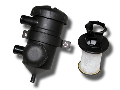

Well, I was contemplating getting the Lingenfelter Air/Oil seperator but saw someone selling a used Provent 200 for only $60 shipped. I looked at the highly detailed PDF: PROVENT 200 PDF
I found that not only was the Provent 200 identical to the one that Lingenfelter was selling but it was ~$25 cheaper (BTW, the cheapest I have seen the PROVENT 200 go for brand new is $129 w/o shipping).
Here is a pic of the Lingenfelter one:
If you go back to the PDF on the PROVENT 200 do you see a difference. Yeah, me neither.
Not sure if this separator is too large for my tastes in the engine bay but we will see.

Catch can's catch the oil and store it.... this separates and returns the oil
Actually, one hopes that it catches it and stores it...most time it doesn't get all of it and some still gets by but it does make a difference vs. not having anything at all. I recommend at least having a catch can on your turbo engine. The PROVENT 200 is just a little more sophisticated catch can that does a better job at collecting the oil vapor and gives you the ability to return the collected oil.Sabre wrote:Catch can's catch the oil and store it.... this separates and returns the oil

I was just trying to state that the standard catch can doesn't come w/ some form of collecting medium so basically the vapor goes in from one hose, swirls around in a box like area and then goes out another hose...so you would hope that it would collect/catch the vapor. Julian was stating that it would catch the oil (implying that all oil vapor traveling through would be caught which is false)...and everyone that knows catch cans and how they work would know that but a newcomer to the catch can wouldn't. That is what I was trying to emphasis so he would better understand it.
