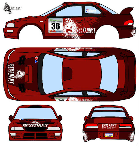

So the first livery design prototypes are done. Just did a few colors. More than likely it will be the red though. Still need to add sponsor logos. Just figured I'd get these out the door now to give an idea of what the final product will likely look like.

on the side view I'd put the "revenant raceworks" above the rear tire and make the logo larger or maybe angle it across the tire /o .
but I'm not a graphic designer...

Ask and you shall receive

I like it a lot more!

I had actually considered it when I started and then somewhere along the line it slipped my mind to try. I think I was so focused on the individual aspects that I missed the obvious solution to the size.

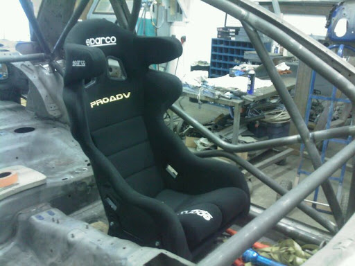

Well the trip to New York went well. The primary goal was to get the car tailor made for my dimensions and driving position. This is a step that some skip but putting the extra effort into tailoring the car exactly for me should provide an even better result.
So basically the two big items on the list were to finish the seat mounts for the driver seat and figure out a steering wheel mounting solution. Both were accomplished and the end result is fantastic.
There are far too many pics so here is a link to the picasa album so you can view them yourself.
